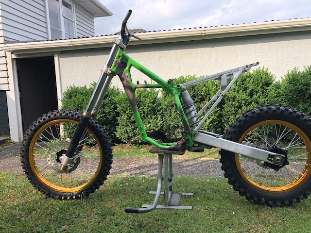

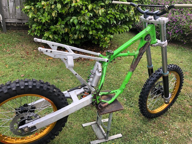

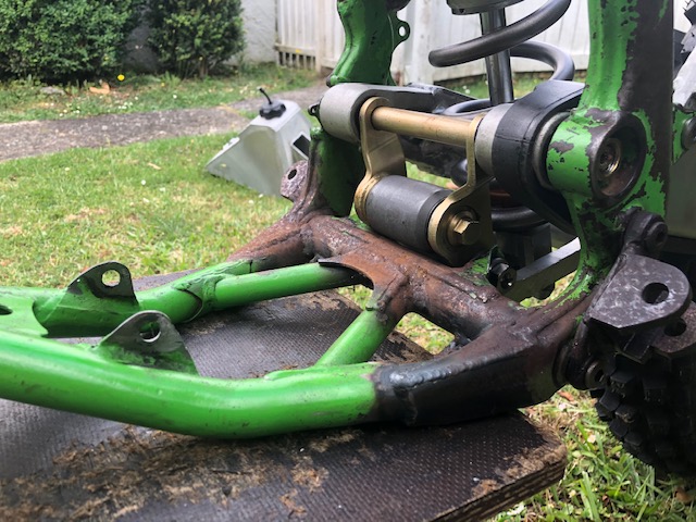

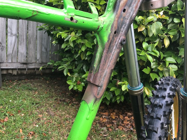

Thought I'd share some pics of my project. '87 C2 motor in an '89 KX125 chassis. I had the frame built using the downtube and lower cradle from an '86 KX125, mated to the 1989 KX back frame. The hybrid was originally in the 86 frame, but was too cramped to access the carb without pulling the subframe. The '89 is a more spacious frame, plus all bearings and bodywork have later KDX parts availability.
The rest:
'97 RMX250 Showa 45mm forks and triples.
Stock shock with late YZ Ti shock spring and footpegs

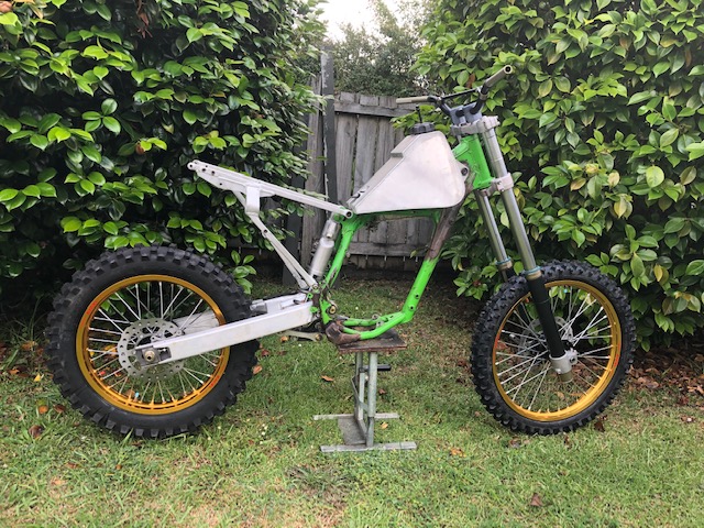

Ally tank - basic but does the trick :)
New Excel rims.
This is just a quick assembly to work out side-stand bracket mount position, then all apart for powder coating.
Hoping this will be my do-it-all machine. Trail riding, Vinduro and the odd XC. And my motivation to get a better set up garage.
More pics over the next few weeks.

Nice project. With the KX linkage rear, long travel forks and full discs aren't you limited to the modern class in Vinduro?

Yes I'd be in with the 90s bikes but that's ok. The concept behind it was more of a modern low tech woods bike. Good handling and suspension with the simplicity of an air cooled power valved engine. Less things to breakbufftester wrote: 01:01 pm Jan 02 2020 Nice project. With the KX linkage rear, long travel forks and full discs aren't you limited to the modern class in Vinduro?

Very cool! Can you explain the need for grafting on the lower part of the frame from a different year? I'm not familiar with the frame layout on those bikes.
