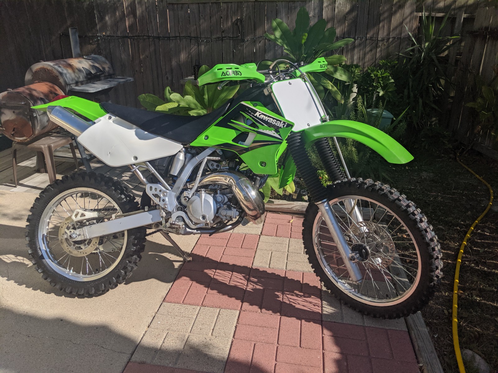

Well after almost two weeks of being cooped up in the shed while doing the go-over, I was able to bring the ol' 220 out in the sunshine this morning.
IMG_20191104_095802 - Edited.jpg (597.11 KiB) Viewed 2530 times
The intent of the test ride was to see how my carb cleaning went and to warm up the transmision oil before changing it to what I knew would be fresh. The bike had good pull and acceleration. However shifting into the upper gears was not an effortless or thoughtless task. Sometimes is was 2nd, sometimes 3rd and even 4th. I did change the postion of the shifter to a little higher postition, but after the ride this morning I'm thinking about bringing it back down to see if that helps.
Reading through some transmission threads here, some say that ATF-F is a choice, while others use motor oil. What I drained out of my bike was some clean motor oil. Just wondering what the consensus would be on the shifting woes on my bike. Try some ATF, stick with motor oil, change the position of the shifter, or learn how to shift :lol:
Thanks in advance!
EDIT ALERT!
After having my lunch while writing the above post, I went back out to check on how the oil draining process was going. Checking the drained amount, it was less than 16 oz while it should have been closer to 24 oz. That could have been part of my shifting problem. Also, reading few more threads on transmission oil, I saw where a few were using 80w gear lube. I know my RoadStar 1700 used that in the trans.
I think I'll hop on the KLR 650 and run up to Walmart and buy some of their conventional 10w-40 dino oil then call it a day. I'll set the sag tomorrow.

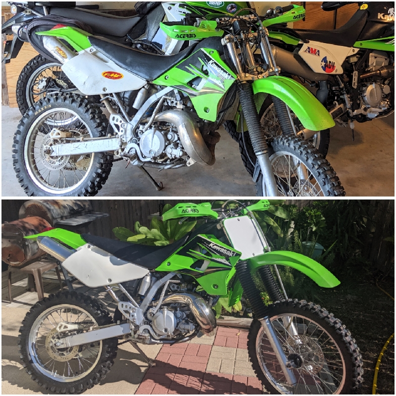

Thanks! It took a little TLC to get it to that point. Would like to eventually replace the rear rim as it's bent with a small crack. Justifing the coin for another one is a little hard especially when the one on there now seems to be pretty true and rides fine.
Here's a before picture (when I first got it home) and then and after picture.
Kdx comp_resize_7.jpg (596.52 KiB) Viewed 2500 times
And If I may, what brand/type are you running? -- Thanks again.
