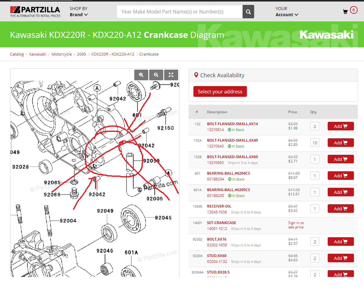

I see there is one but no one seems to be documenting it. How is it called if not swingarm bearing? Any videos on this?

I am not sure which bearing you are talking about. Can you post a link and the reference number on the picture? Thanks!

See attached image. Hope you like my drawing.

Where’s the bearing? Part #? Mine doesn’t have a bearing in there.
Re: Greasing swingarm bearings without removing wheel
No bearing there, just a hollow section.
92042 are pins to help with alignment.
I just stuff mine with grease and move on with my life. It’s too tight for a bearing.KDXGarage wrote: 05:38 pm Aug 12 2019 No bearing there, just a hollow section.
