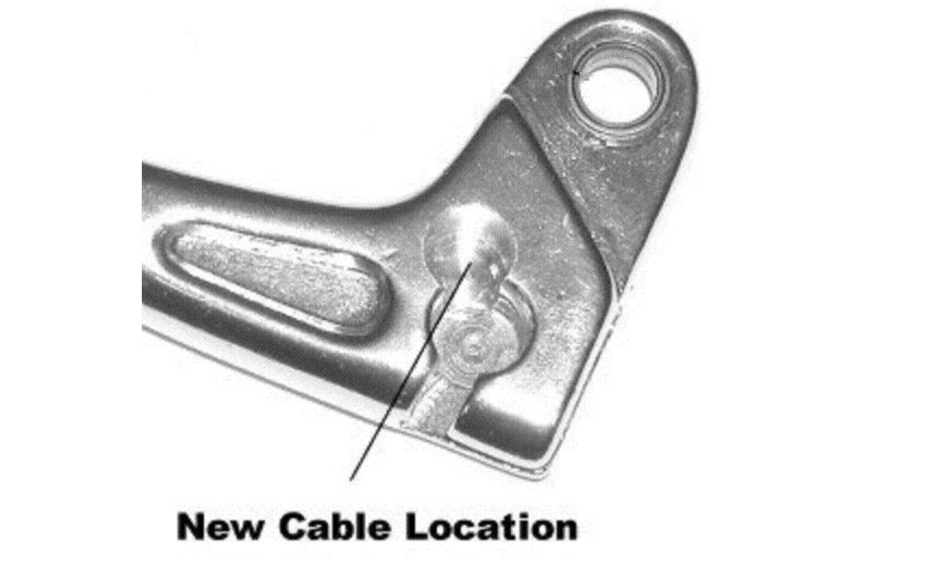

Yamaha 450 owners use this easy mod to decrease lever pull effort, I’ve seen it done and it does work

Yes, there is something wrong with the operator. It's called aging, and it sucks. For me, it's given me arthritis in my hands which forces me to use two fingers on my clutch. Despite that, many of us old-guys are still out there hitting the trails. If I can add a cheap mod that will help me keep at it into the future, I'll do it. It's either that, or I should start shopping for a new wardrobe accessory, eh? :yawinkle:
