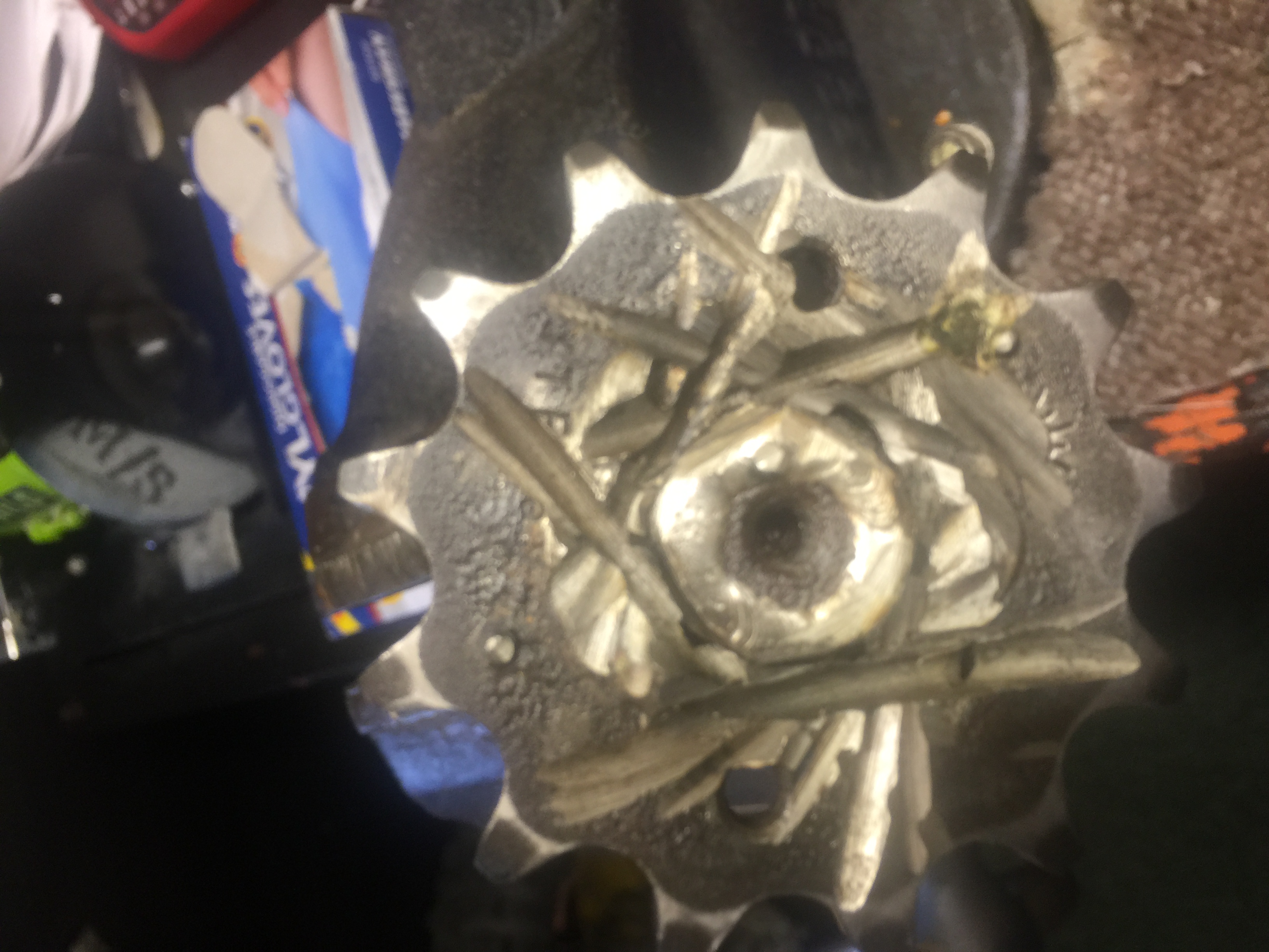

Welded front sprocket
Re: Welded front sprocket
Just my $.02 but it would seem prudent to consider an overhaul of the bottom end and all bearings and seals as a minimum. If this is an example of the PO's maintenance you might be better off to get ahead of the game here. Just a thought.
Bearing supporting that shaft at a BARE minimum
KDXGarage wrote: 03:51 pm Jul 19 2019 chain tension may have gone awry
That or a sloppy fitting sprocket from the get go or one left on way to long and then becoming sloppy. The counter shaft sprocket will wear just like a clutch basket from being on/off with the throttle only a lot slower.
Post by Strictly Kdx »
I would use a die grinder but don’t cut too deep, you can shave it down then give it a hard tap to crack the weld loose but what I’m wondering is maybe it was welded because the spline teeth sheered, this happened to my bike so I welded it a certain way to take it off when I’m ready to replace it.
Posts: 3553
its normal for you to turn the output shaft and have a little play before the input shaft turns. Not changing sprockets and incorrect chain tensioning over a long period can cause this kind of wear. Someone did not believe in pre/post ride maintenance before you got it lol
Post by Parney »
Well here is what’s left when I got it off
Post by Parney »
What a mess but now
Post by kdxsully »
Parney wrote: 01:58 pm Aug 02 2019 Well here is what’s left when I got it off
That’s crazy. Good luck in finding an air cooled. I love mine.
