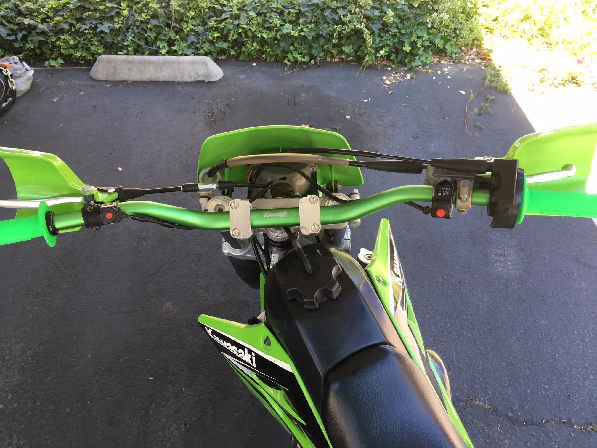

Well finally got some Renthal Fat Bars and ODI lock on grips. I used the Tusk Fat Bar adapters. Just a heads up, the bolts that mount the adapters to the current clamps are too long and thus don't tighten enough. Had to go to ACE and get shorter bolts, but after that no problem. They are definitely wider than the stock bars, so I may be cutting them down pretty quick as I prefer the narrower feel.
I also had to remove the stock odometer, which isn't really that useful but more nostalgic than anything. Will eventually get a Trail Tech. For anybody that has removed that, what did you plug the hole on the fork with, seems like you wouldn't want to get dirt or debris in there? Anyhow, looking forward to seeing if there is a difference. Now onto the Forks!

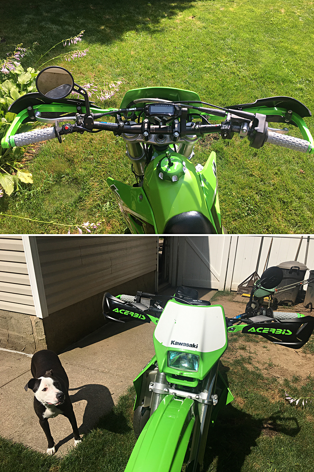

I ended up using the rubber "foot" from a foldable chair. Im a firm believer in cutting my bars down. I usually take a half inch off each side but I ride in lots of trees...Hey at least you still have the red boot for your light switch. I have to cover mine with gorilla tape for the wet days!
Heres what my "cockpit" and TrailTech etc looks like. And a look at my new handguards. I love ACERBIS stuff. But dang they were $30 more than the Tusk D-Flex and others.

That's the gold standard right there. Was the Trail Tech an easy install? Electrical work always seems intimidating to me. Are you running it off of the current stator, or just a batter?TwistedRoot wrote: 09:31 am Jul 11 2019 I ended up using the rubber "foot" from a foldable chair. Im a firm believer in cutting my bars down. I usually take a half inch off each side but I ride in lots of trees...Hey at least you still have the red boot for your light switch. I have to cover mine with gorilla tape for the wet days!
Heres what my "cockpit" and TrailTech etc looks like. And a look at my new handguards. I love ACERBIS stuff. But dang they were $30 more than the Tusk D-Flex and others.![]()

Super easy to install. Running off the watch battery now. One thing to remember is if your planning on swapping to USD forks you will need the sensor that will mount to the fork guard. If your using the conventional fork the sensor is now "curved" to wrap around the lower fork. It uses double sided tape which I dont really like. They stopped making the "flat" sensor that would screw into the caliper, so its down to these 2 sensor styles.

They are super beefy. I really like them. Was looking for something newer to replace the older ones I had on. Like I said these were approx $30 more than the others but I like the look and color is a perfect match.GATOROC wrote: 09:13 am Jul 12 2019TR - I love those handguards - they look beefy! I also like the TrailTech and will probably ping you later to get the specifics on it and how you mounted/wired it.TwistedRoot wrote: 09:31 am Jul 11 2019
PS- I run the TT to my battery on my other bike, but so far I haven't had any issues with running it off the watch battery. Its 1.5 years so far.

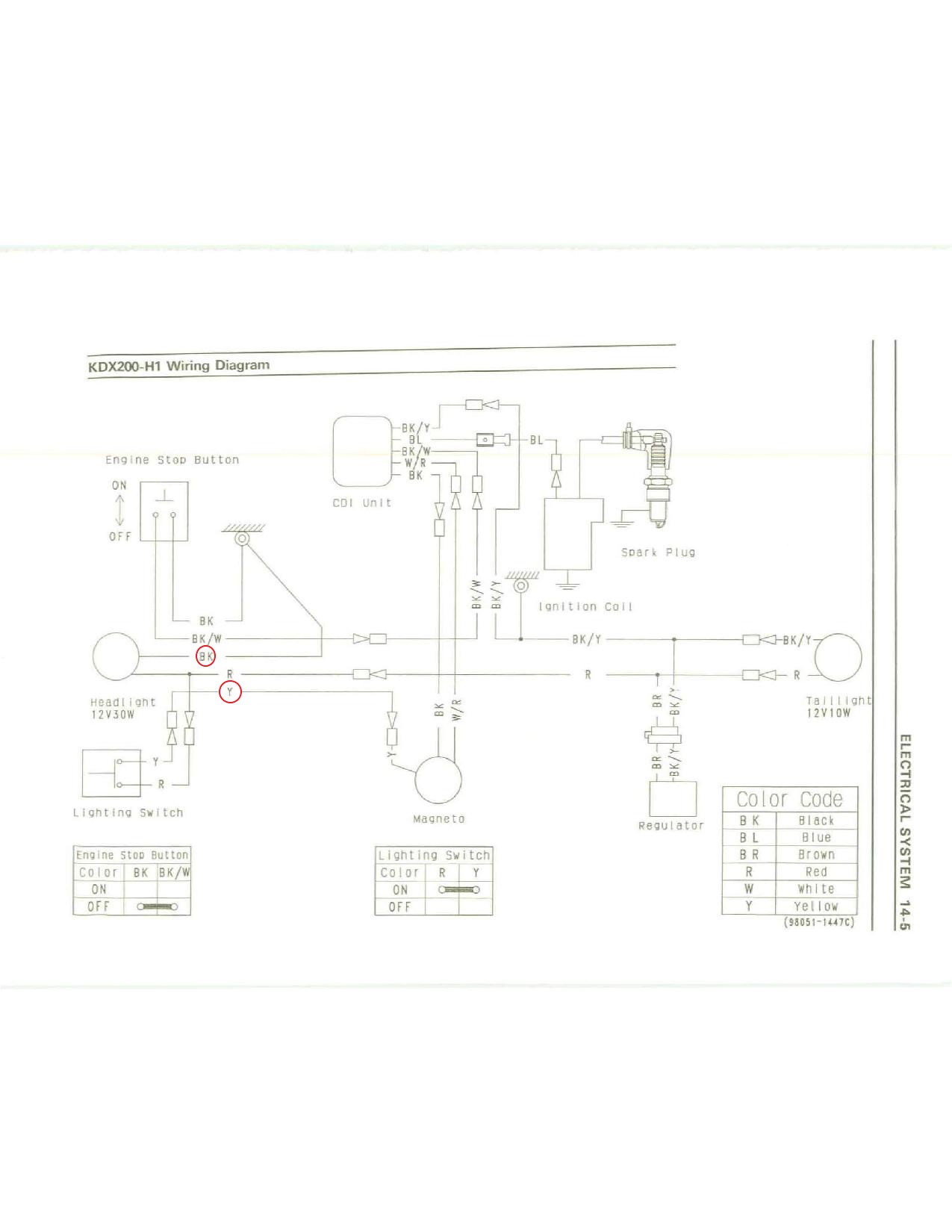

I wired my Trail Tech Endurance to the stator since it will run off DC or AC.
It appears to be the same as the one sold by Trail Tech. I just drilled a little hole in my front number plate to mount it. It's totally waterproof and works great.

Here's a wiring diagram which shows how I wired my Trail Tech. Up under the headlight, tap into the Black wire going to the bulb for negative. Tap into the yellow wire before the connector for the headlight switch for AC positive. Trail Tech recommends a 1 amp inline fuse on the positive.
