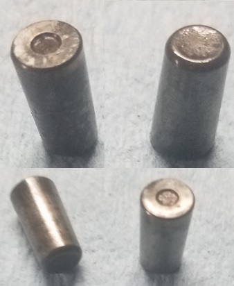

Ughhhhh, i have always seen these types of posts and think to myself 'how can you be so careless that you forget to put back a bolt/washer/pin/etc' yet here i found myself in this very situation.
The pins in question are about 5.75mm x 11.75mm and have a rounded side and a flat side with a 2mm dimple in the center. Both pins have the same rounded side and flat dimple side, which kinda made them stand out to me and left hopes someone may recognize what these went to. The pins did have some build up on them which made me thing it was an external part, but in the state of the maintenance when i got it means that grime could have been internal or external.
My first instinct was to check the gasket location pins on the jug, head, and KIPS covers - but all of those were well in place and overall too small to match the pins. I checked out the parts fisch and found 99% of the pins used are listed as "610: PIN DOWEL 4X8 - 610A0408" and all of them listed in the fisch were present. There are no other pins i could find in the OEM parts guide - so im leaning to say they are from another project and just got missed until just now.... but want to check with the community first incase anyone with lots of KDX maintenance and work recognized them with that unique dimple on each pin
I posted some photos below, take a look and let me know if you have any ideas!!

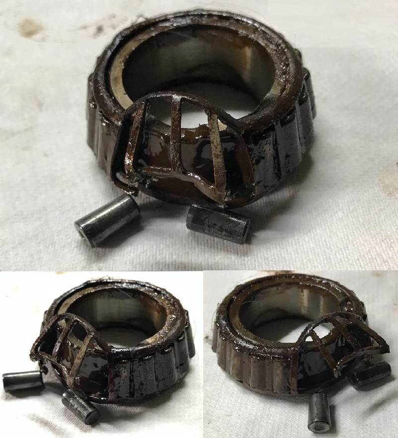

Well, first off i want to thank everyone for throwing out suggestions and helping me research possible causes!!! :prayer:
This afternoon, i was getting ready to check the clutch cover and my neighbor walked over to the garage. I explained my worries about the pins, and happened to have them on the work bench so he decided to take a look. First thing out of his mouth was 'well these look like they used bearing roller pins for whatever they are' and it dawns on me.... the lower steering stem bearing exploded when i was getting it off with a cold chisel.
Even better - I don't throw away any old/damaged parts removed from a project (seals, cables, bearings, etc) until i have the job finished and verify the end product is working as expected... just in case i need to reference back to what i had on there previously if i run into issues following a change.
Well sure enough, check out what i found below in my KDX bad parts bin!! Steering stem roller bearing with an exploded cage and missing a few rollers. I dug around the ground by the washer where the bearing exploded and found the 3rd missing roller on the carpet rug next to the garage door. :supz:
Pin_Source_found_SteeringStem_Bearing
Anyways, im really glad to find the true source and can continue with my project and fire it up without the fear of missing parts. Again, a huge thanks for everyone looking into it and trying to help me figure it out! :drinkers:

Well, they will still work as locating pins if you need them. They aren't square though, slightly tapered if they came out of a roller bearing, so one end will be slightly larger diameter than the other. This is one of the reasons (I keep telling myself) that I never throw away old parts lol
