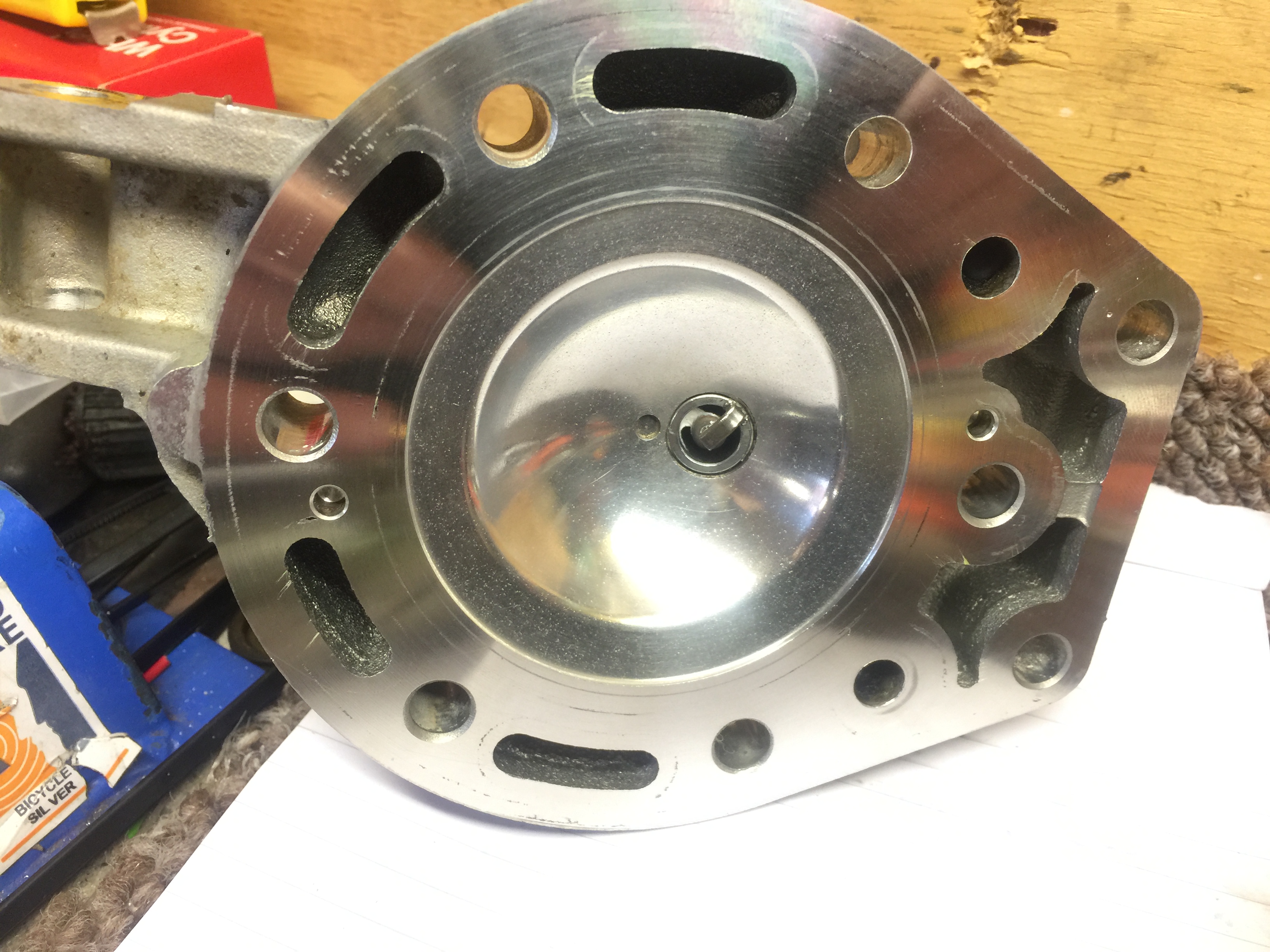

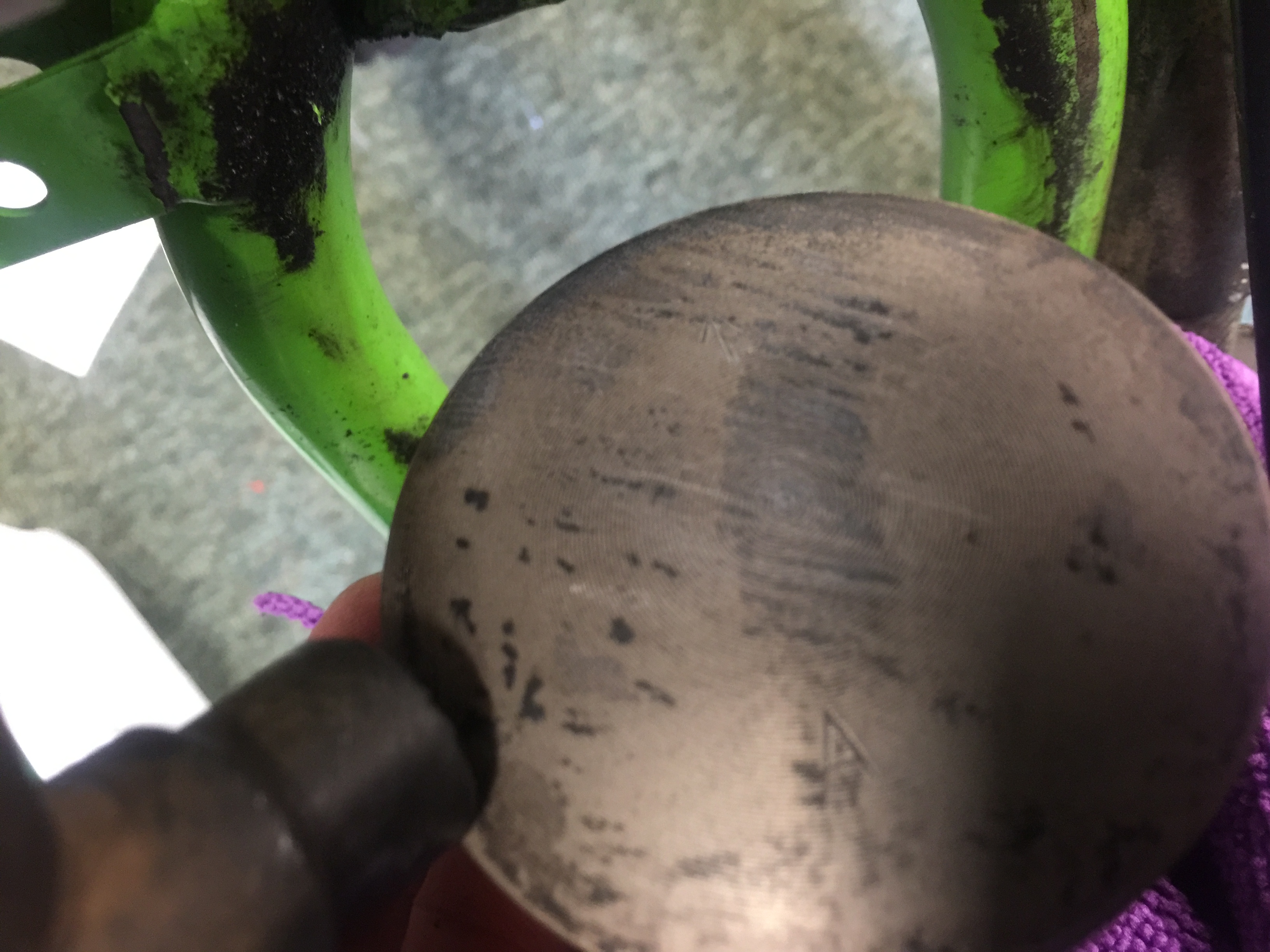

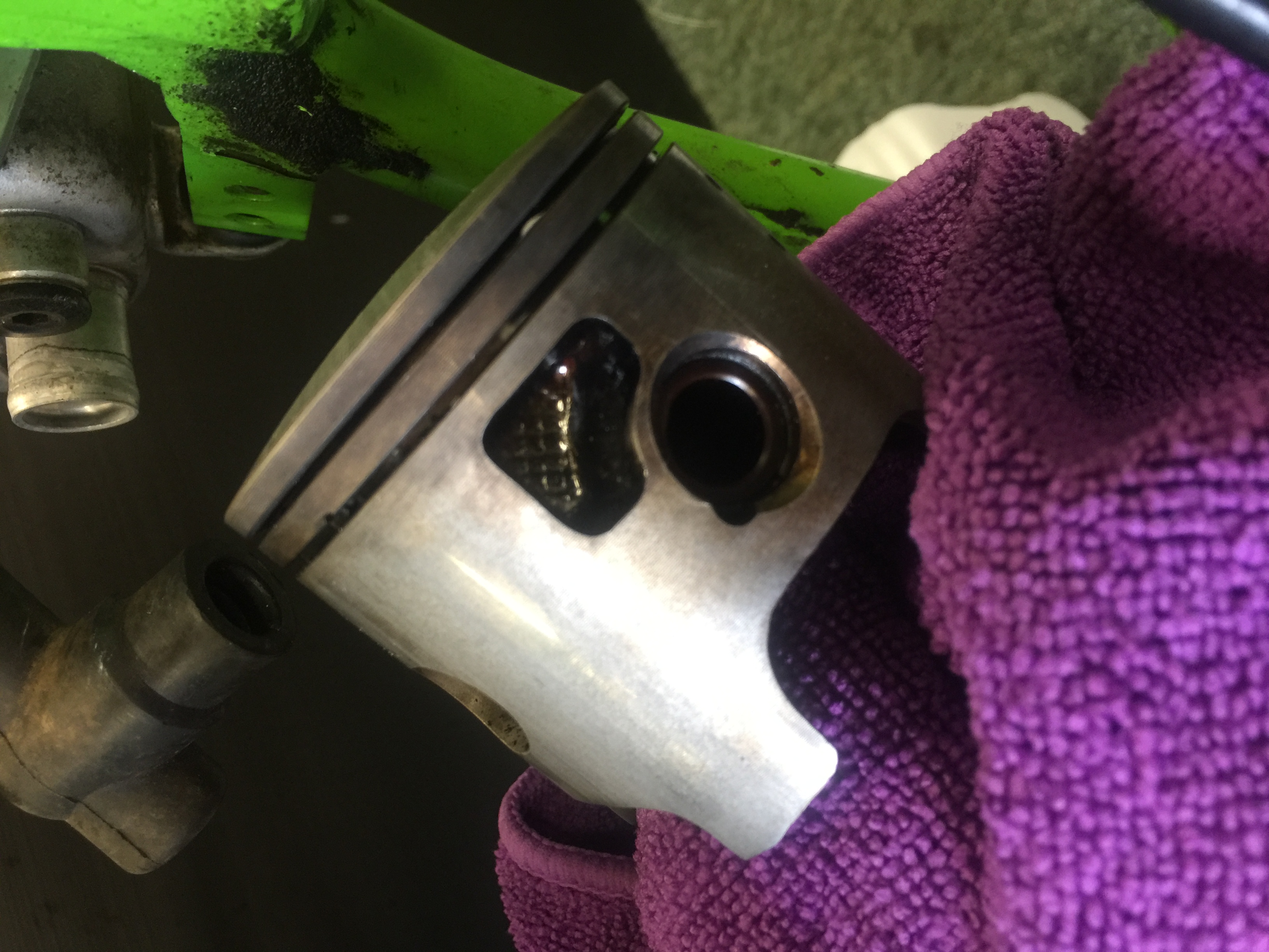

I bought a kdx 220 quiet clean inside my piston has A top I take it this is standard
Re: Piston
That looks like the stock piston.
Did the previous owner mention head work? Does a stock head look that good??

Totally standard wiseco piston arriving tomorrow bike only done 4000 miles I put motul 5100 in gearbox 10/40 the clutch slipped really bad

Did you clean the piston top while it was still attached? Sounds risky.
Measuring the piston diameter before ordering another piston would have been a good thing, just in case.
