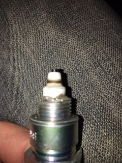

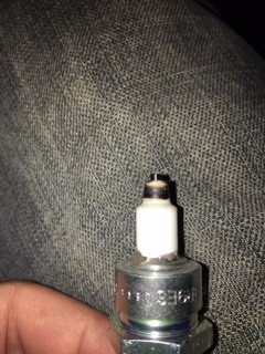

SilentCarl
Posts: 5
Joined: 12:32 pm Jun 11 2018
Re: Another Jetting Question
Post by SilentCarl »
I warmed the bike, swapped to a new plug, did 1-6th gear WFO pull and killed the motor. Plug looked almost completely clean but the electrode was white-ish. I'll retest with the 160 main I have installed currently and post a picture.
Maybe I am just rich and not reading the plug correctly.

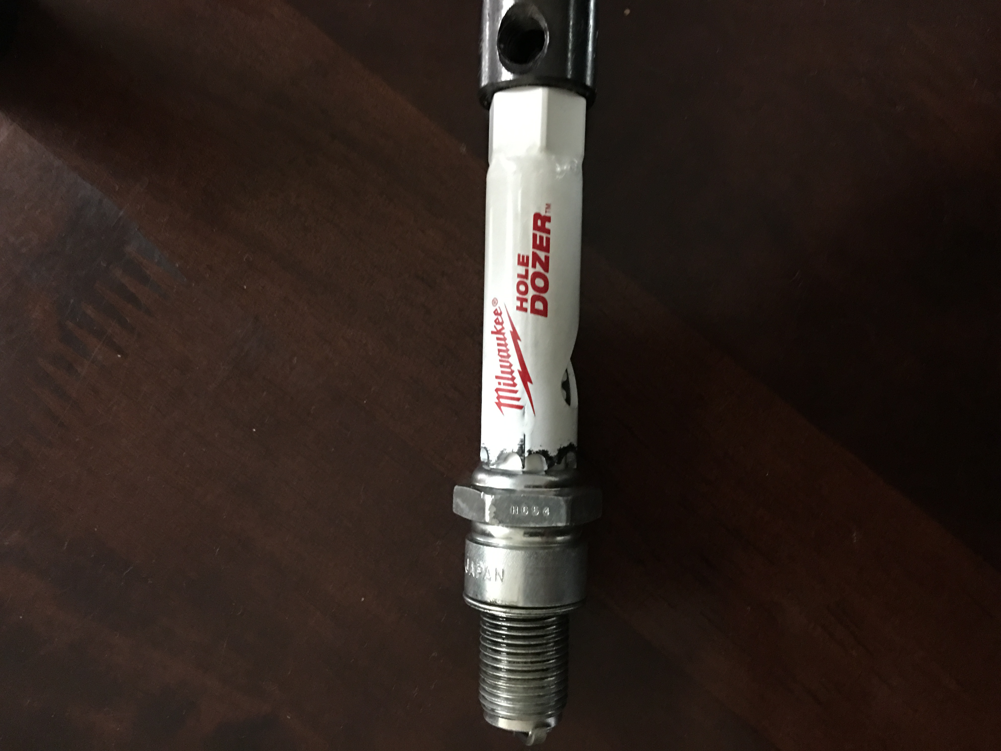

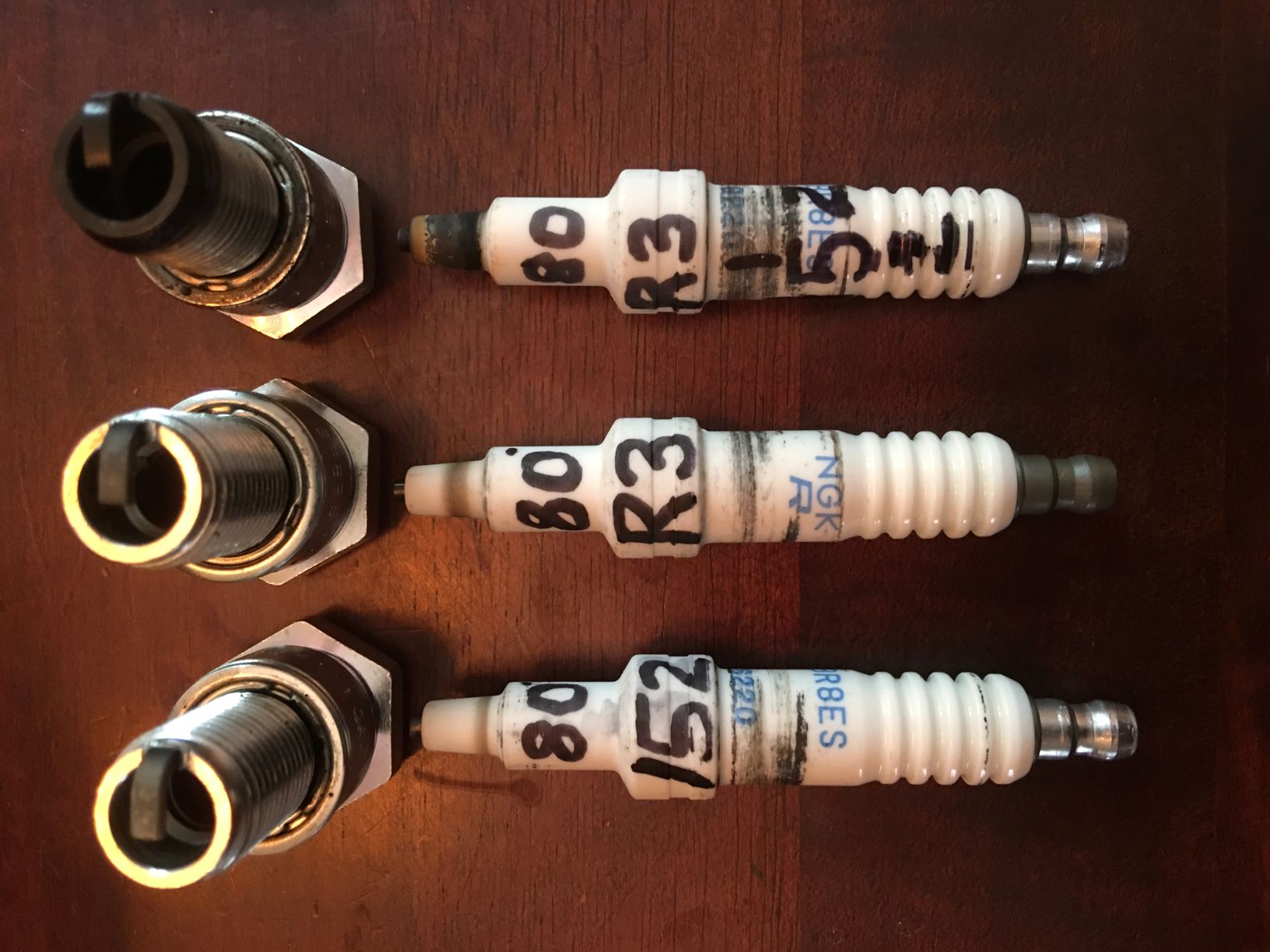

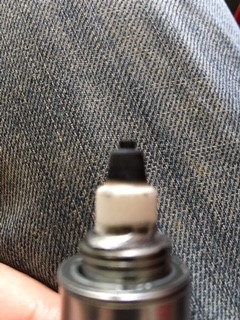

Here are some pictures of plug chops if it helps reading your plug. These were all done with 1st to 4th gear wide open because I didn't have space to run 5th and 6th. The engine was at operating temp and they had two runs on each plug, one run away from the truck pulling in the clutch, turning around and then 1st to 4th again back to the truck, this time pulling in the clutch and killing the engine. This was on a Honda 250 but I went through the same thing with my KDX, starting too rich and working down. None of these main jets made the bike stutter rich but the 150 made it so run so much better and have about 2000 more max rpms. A huge difference.
Heres a 160 main
Heres a 155 main
Heres a 150 main
The 150 main picture is what your looking for. A 148 would've probably been perfect dark tan colored. I've never had good luck looking down into the plug even with a light and magnifying glass. These were cut off with a grinder. If you're going to do multiple plug chops a 5/8" bi metal hole saw bit on a drill makes the job MUCH quicker.
The whole ceramic ends up pulling out like this after about 10 seconds with the drill
These plugs were from my 02 KDX 220. The bottom plug is a main jet chop, the middle plug a 1/2 throttle chop (3rd clip down on the needle), and the top plug had 25 hours on it. I like how on the top plug you can still see the 3 different circuits, the main jet (too rich), the needle (almost there), and the pilot (good). For my type of riding (slow to mid speed trail) the needle clip in the 2nd position and a 148 main have the best throttle response, the plug looking dark tan all the way down and no oil running down the silencer.
I did all this while my back was too hurt to really ride but i couldnt resist being out there. One thing I didn't expect to see such an improvement on by doing this was the fuel consumption, it made a night and day difference to the hours of run time per tank (over 5 hours now). It used to go through a tank in a couple hours. I really think its worth the time and effort to follow the jetting guide listed on this site.
