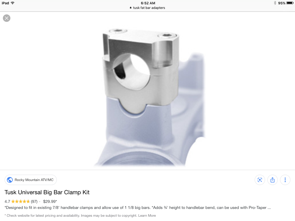

You'd have to run something like this if you want the 1 1/8" bars on the KLX triple clamp.

John_S wrote: 06:00 am May 03 2019 You'd have to run something like this if you want the 1 1/8" bars on the KLX triple clamp.
Yes sir. I ordered those and I ended up going with the Renthal Fat Bars. Also ordered some lock on grips. I have never used them before but read enough positive reviews, so figured they were worth a go.
