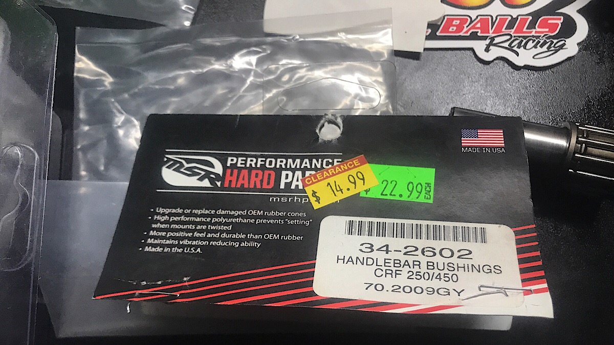

Issue resolved - went to my local KX store with a tape measure and found a set for a CRF450 /CRF250 mounts were just about the same exact size as the stock KDX ones so just went with that.
Thanks for all the help guys!!

Congratulation on finding some. Part number for people in the future?

Re: Replacement Cones Question & Pics of Renthal Green Fatbars
Noooo problem man!!
You posted the photo which helped out a ton once I got to my local MX store and just started to check the various ones in stock.
I ended on the MSR Hard Parts - Handlebar Bushings CRF250-450 which is a poly cone that has more of a firm feel compared to the stock ones but not as stiff as the billet ones would be.
First Number) 34-2606
Second Number) 70.2009GY
I will note they were on the slightly smaller size like the Ride Engineering ones Voss posted a picture of - so I just used a set of washers the same OD as the cones to get the clearance needed for the provided curved washers.
I got mine on the discount rack at the local store... so the cones may be discontinued as I can’t find any info on the MSR website about any bushings at all and lots of retailers I found with google search on the two part numbers above show out of stock unknown restock date.
Hope it helps someone!
Oops, forgot to attach a photo of the pack for reference!
I will grab some photos of them in the cone holes so you can see how far they set in - it’s just a few 10th of a mm but that’s why I threw and extra washer on there for clearance and worked out perfect for me! (YMMV - Goooooood luck!!)
