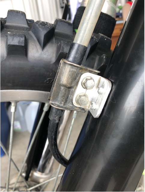

Modifying and updating a 20 year old KDX to be competitive with modern bikes opens the door for even more "little things". I have KX250 forks from the time when Kawi ran the brake line under the fork instead of wrapping it behind the lower fork tube as on "modern" bikes (and a stock KDX too!). To solve the problem of how to attach the KDX brake line to the fork guard I've fabricated a plastic tab riveted to the fork guard. It worked sorta, but has failed me twice now so I recently fabricated a new bracket out of aluminum stock that will hopefully be a little more durable.

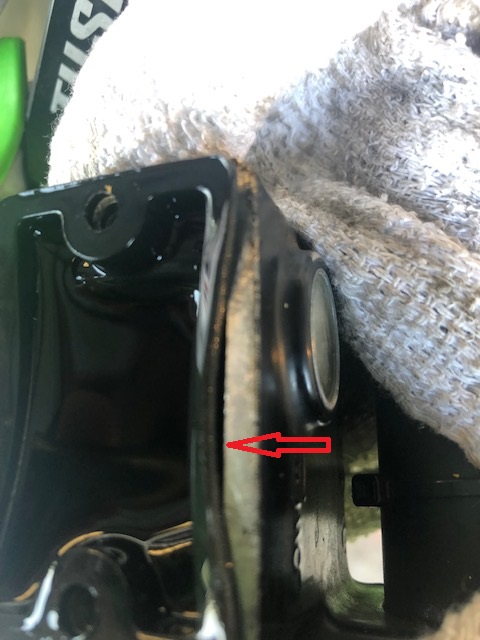

Another "little thing" popped up yesterday while I was doing some bike work. I have a left hand rear brake set up. Lately I've noticed I am loosing brake fluid in the master cylinder. It's a very small leak and hasn't affected the rear brake yet, but just another distraction on the trail when I should be giving the ruts, roots, rocks and trees my full attention! Yesterday I noted through the site window the fluid was low again. (I've never found the source of the leak.) When I took off the cap to fill the cylinder, this is what I saw:
LHFB master cyl..jpg (99.16 KiB) Viewed 34764 times
See that little gap between the gasket and the edge? I wonder if that is another "little thing"? Dunno' but I paid more attention to seating the seal this time before tightening down the cap for sure!

Maybe it was not leaking there. They CAN be tricky!

If this is an old clutch actuator Rocky Mtn sells the replacement bellows; I think that's what your picture is? RM's number is 131307001013 it's called a "bellows for reservoir '98". Buy two b/c Magura doesn't make any rebuilding stuff for the older units. .........If it's new Magura sells it........KDXDave Although KDXGarage has it right figure out where the leak is. If it's coming from the actuator you can nurse it along for a while......
Thanks, guys! It’s a Nissin unit but I haven’t started looking for repair parts yet. Actually thinking of switching my Magura hydraulic clutch system over to a LHRB unit with a new custom made line.

YEP! One braided SS line from the clutch actuator to the the master on the rear wheel. Easy simple...Pick a hot day to install be ready to bleed all the way through. I use a good gas check valve like on your gas tank to bleed without open and closing the rear brake...good luck Dave
Yeah, that’s how it is rigged up now. I just don’t like the Nissin stuff.
