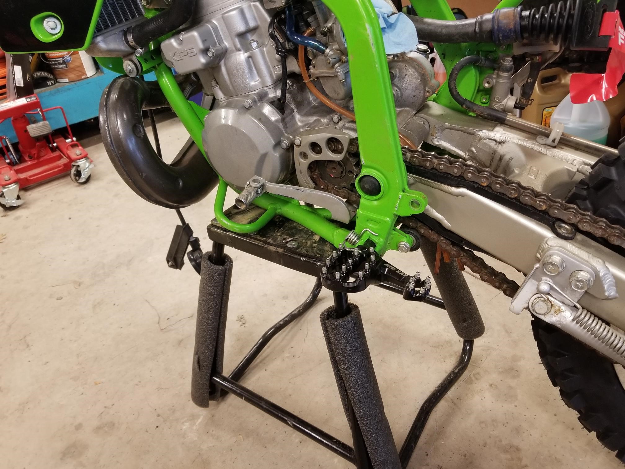

So I bit the bullet and went ahead and ordered the AIR EXT pegs. I went with the ‘02 KX250 models, I figured they would be close and with a little machining I got them to fit. I had to take 4mm off the thickness of the mount, cut down the adapter bushing to the same, grind a little off the pivot side of the mount, and take 3mm off the boss that the adjustment bolt screws into.

I finally got the pics to load. I still need to adjust the right side but they work well. I did about 20 laps in the back yard and they're really roomy.

Re: Fastway Foot Pegs on KDX 220
That's different! Thanks for sharing.
What is the benefit of the pads on the stand? I have never seen that before.
I don't know, it came with them, I guess to protect your shin when you walk through the garage with the lights off? I'm sure you wouldn't hang on the peg first.
I have had my stands beat me up a little on occasion. Trying to move a MX bike with no kickstand while holding a stand doesn't always work out so well.
