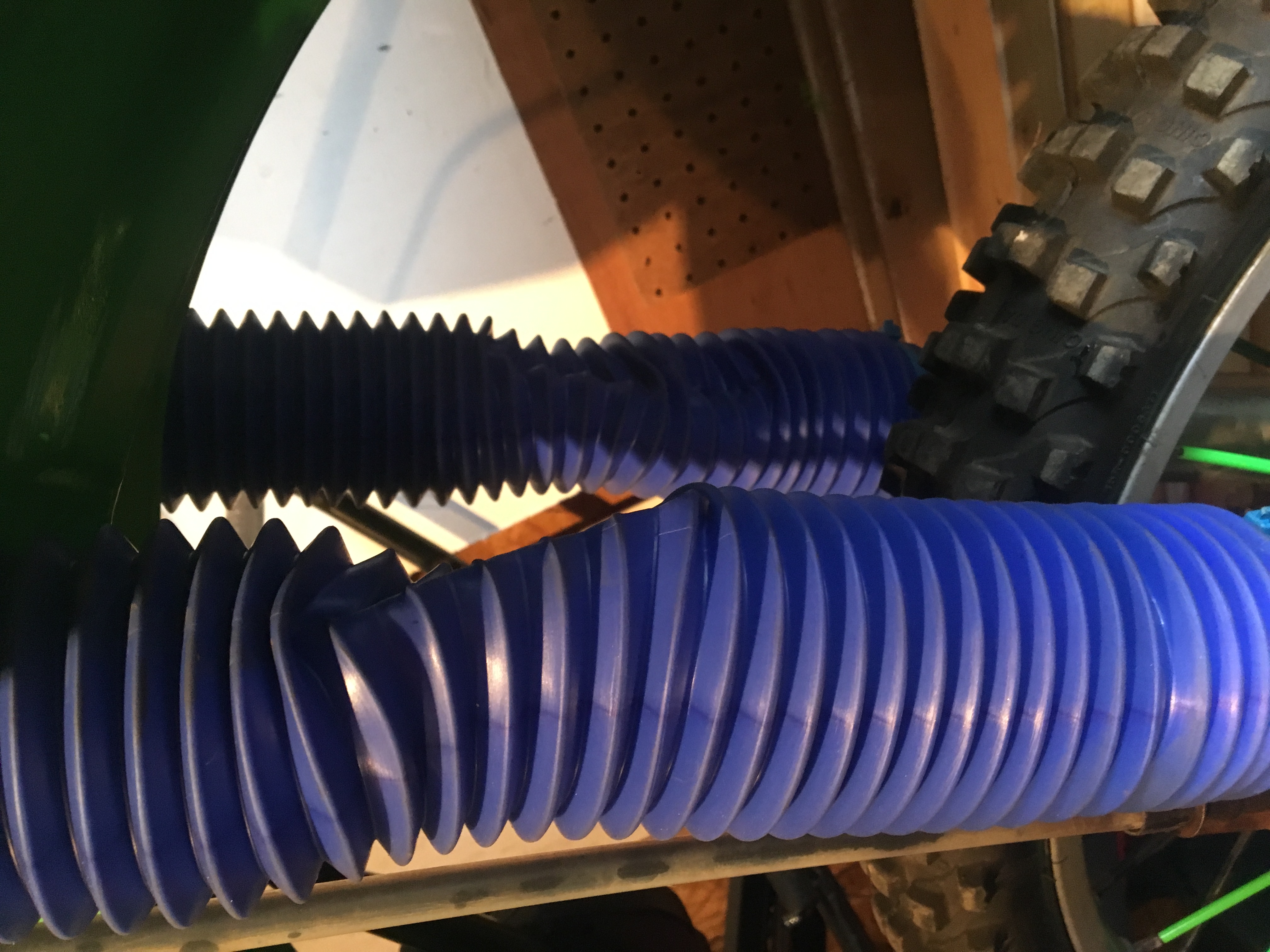

This has been a project of mine for awhile I have had numerous questions asked and answered throughout this process. I currently have motor rebuilt swingarm and linkage rebuilt spoke skins seat cover changed new clutch cable. I’m waiting to find out if the left power valve from the Netherlands
I ordered will show up but has anyone ever replaced front break pads and can not get it reinstalled idk if I’m doing something wrong but that has me stumped. As well can someone explain why my shock covers have went like this they are new shock boots that I replaced and only recently noticed the boots have gone funny but they never did look like it

I bought some new boots for mine that were doing that but not to that extreme. It was vacuum that was creating it on mine. I made a few slices with a razor which I didn't want to do but it took care of it. I sliced on the back side of the boot and in the crease, about a 1/2". you couldn't see the cuts and it wasn't letting dirt in.
Edit: I reread it and it sounds like you haven't rode it yet with the boots. That's unusual as mine would only happen after the forks had been pumping up and down creating the vacuum. They had holes on the bottom but it obviously wasn't enough air coming out.

Used to have that problem with the old KDX forks and it was because the boot had gotten a crease in it somehow and when the forks worked up and down they would end up like that. Doesn't affect them doing their job so I never worried about it.
