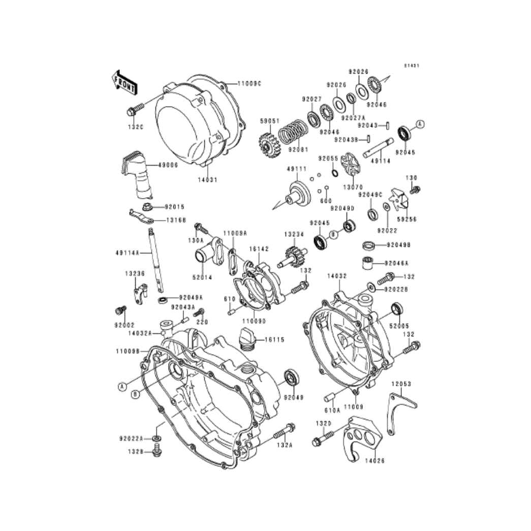

Hello, I'm new to the forums, I looked around a little couldn't really find where this little guy goes fell out when I changed the oil yesterday, just bought the bike last weekend thanks
1993kdxCharlie
Posts: 9
Joined: 08:16 pm Feb 26 2019
Re: 1993 kdx 200 metal piece in gear oil
Post by 1993kdxCharlie »
Think I just found it took off the engine cover and I think it's part # 13236 is that correct
welcome to kdxrider.net
yes, that looks like it

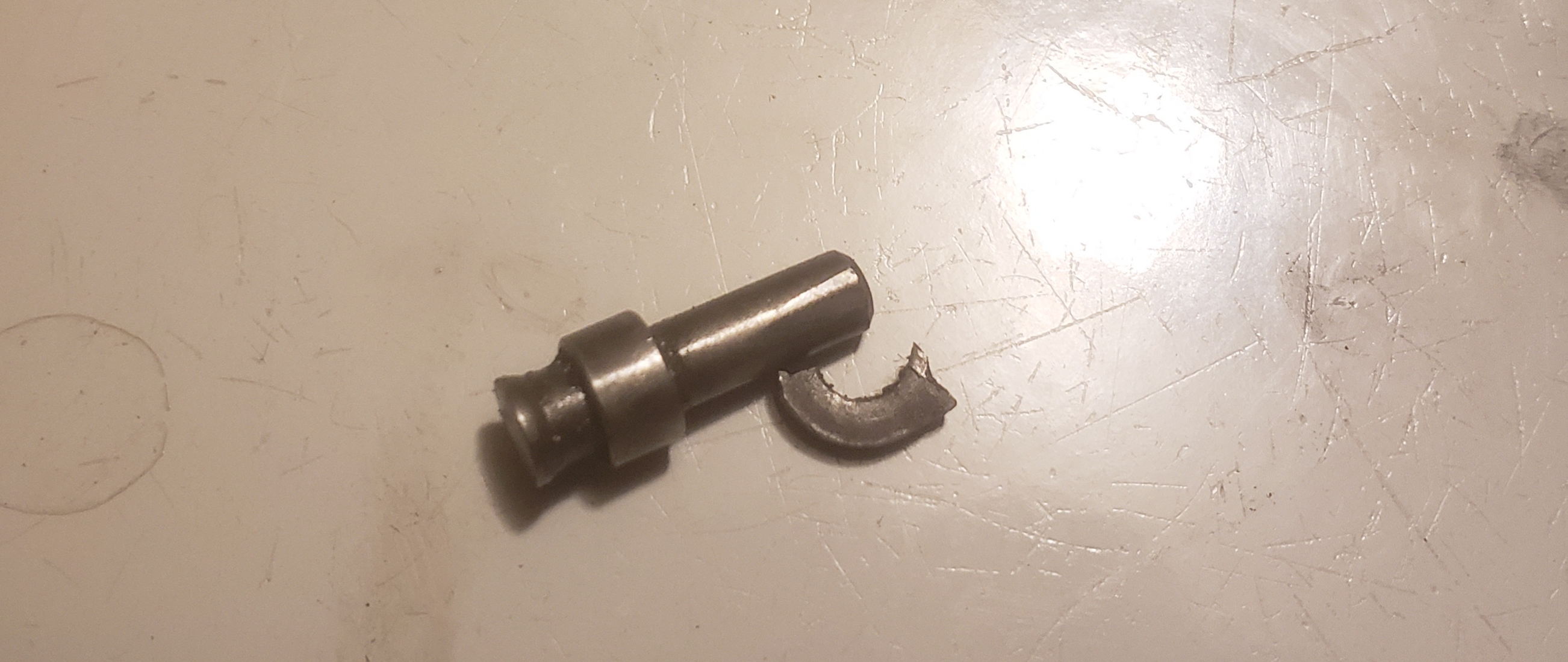

Yes I did I read some story's about it destroying the gears but I removed the whole engine yesterday and pulled the clutch basket and everything to check it out it looked good and I pulled the head and cylinder to check the piston and power vavles,
Found a broken exhaust vavle :rolleyes: the right side one it was froze up I finally got it out and gonna post some pics of the others when I get home to see what y'all think.
Gonna post some pics of the piston to see if it should be replaced, the bore still looked good no deep scratches
Should I check the center rod on the vavles? I couldn't figure out how it came out didn't wanna mess it up

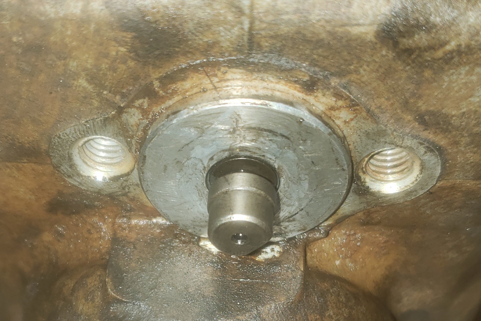

How does the center rod come out the one that has the cover on it near the main exhaust hole
Posts: 3540
  1. Remove the main exhaust valve cover using an 8 mm wrench.
  2. Remove the three bolts that secure the shaft advancer cover to the cylinder using an 8 mm wrench.
  3. Remove the shaft lever nut using a 10 mm wrench. It has left handed threads.
  4. Remove the exhaust valve operating rod retaining screw using a #2 Phillips head screwdriver.
  5. Gently pull out on the exhaust valve operating rod until it stops.
  6. Pull out the main exhaust valve until the machined groove in it lines up with the gasket surface for the cover.
  7. Pull out the idler gear, it's the one farthest to the right.
  8. Pull both of the exhaust valves upwards until the top of the gears are aligned with the head gasket surface.
  9. While the exhaust valves are held in this position, remove the exhaust valve operating rod from the engine.
  10. Remove the subvalves
The service manual and Cyclepedia also have great pics of how it all comes apart and goes together. It should be the first tool you buy.

Alright thanks I'll go ahead and order the manuals but I pulled all the valves out already the one on the side by itself was broke ( right side?) But here's what I don't know for sure if this one is suppose to come out or not I tried to gently pull ot out but didn't budge didn't want to break it.

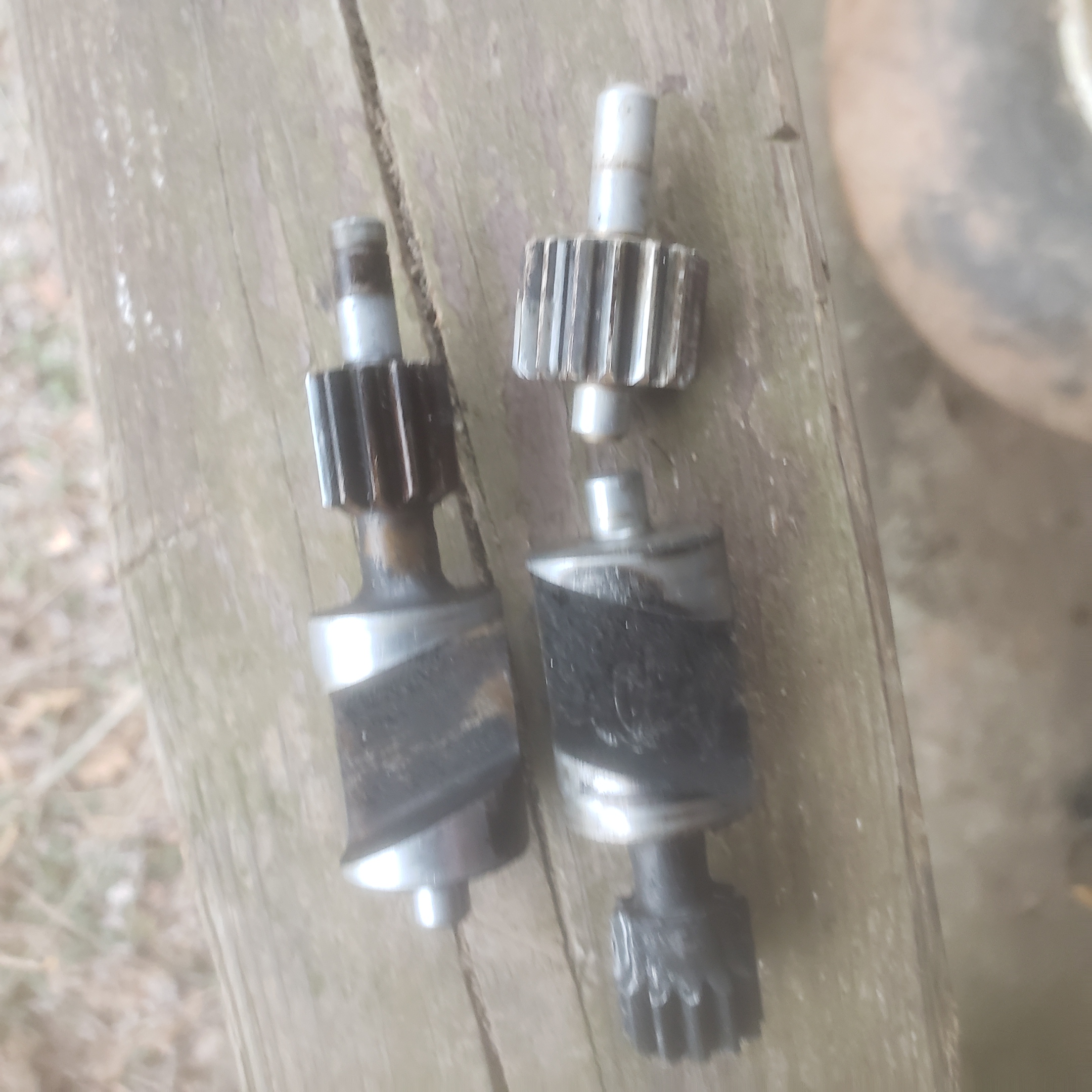

How does these look? (I know that ones broken) should I buy the kit with all them or just the one that's broken and clean the other 2
Thanks sorry for being a noob :kick:

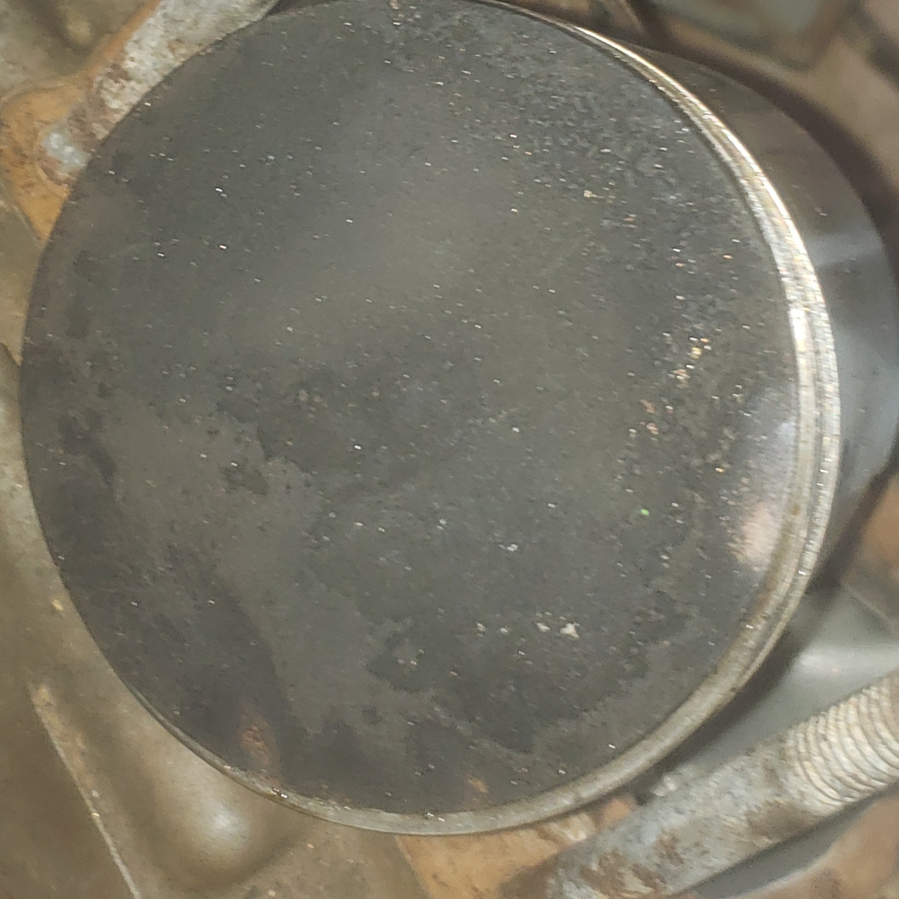

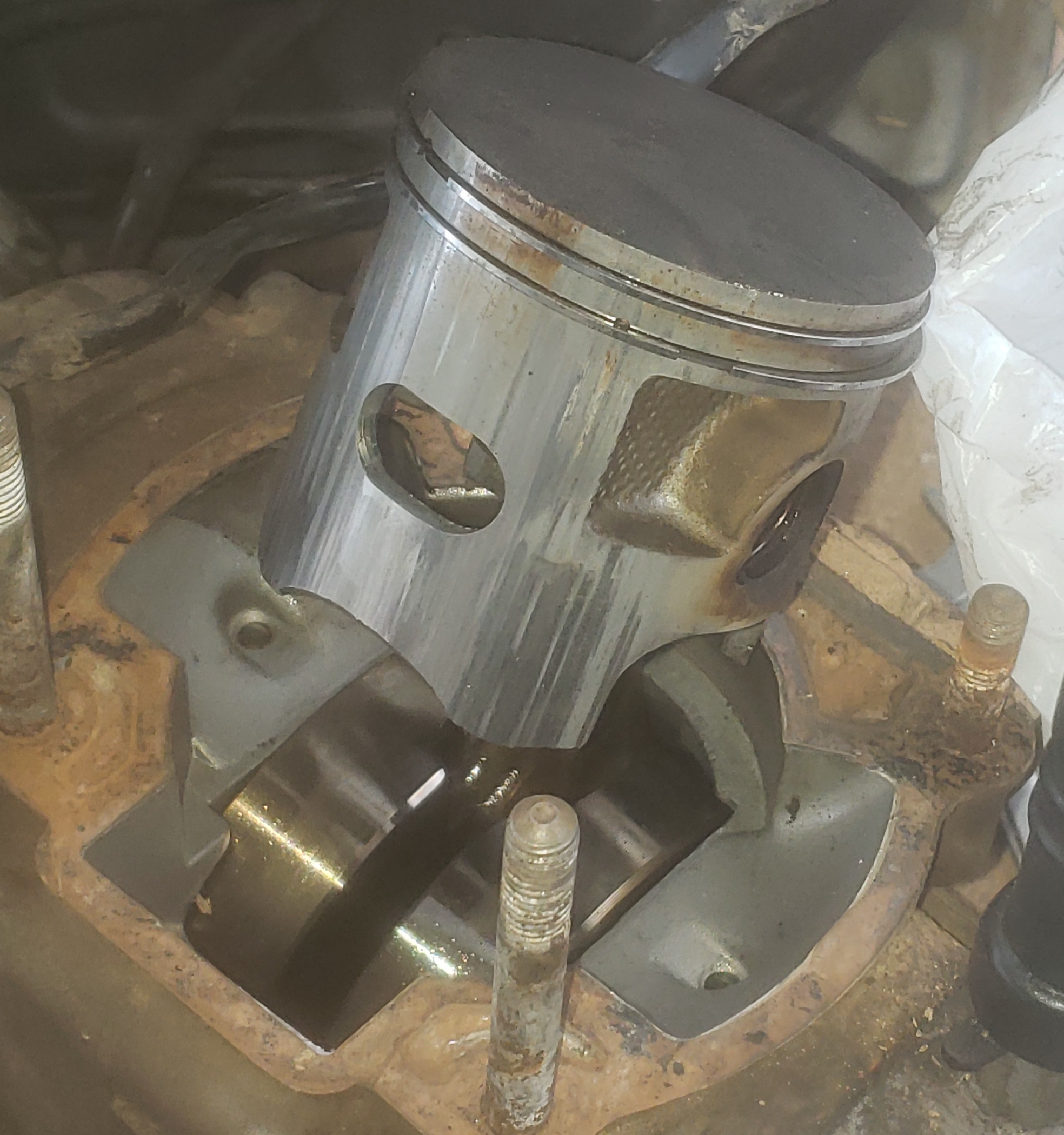

Probably should get one since I have it apart. but just wondering what kind of shape this piston is in
rungrandpa
Posts: 230
Joined: 11:35 pm May 26 2018
Country: U.S.A.
Post by rungrandpa »
I just replaced mine and it looked better than the pictured one. I would put in new piston, rings, wrist pin and wrist pin bearing, assuming your cylinder looks ok.
It does not look like it has been ran for a very long time, but definitely it was rich (all the carbon on top). The scuffs in the front may be from not warming it up properly.
