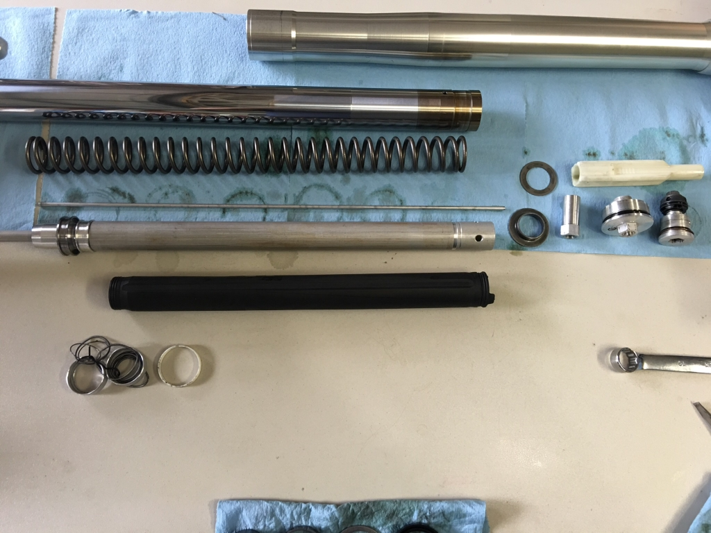

Here is a picture of my 2000 KX forks taken apart. The black tube you see is the bladder and the parts below it is everything related to removing the bladder.
- image.png (1.24 MiB) Viewed 9519 times

One need only remove the white ring to disable the bladder.
Removing it changes the oil level requirements. Either way is fine.

Thanks so much for the images, video and advice everyone. I will definitely research the mid valve modification. I will post some pictures below of the internals of my fork. I definitely don't think there is a bladder unless it has already been removed, or the 99 doesn't have one, or I purchased a different year fork from a major online auction site. Hmm. I kind of believe that it may have been worked on previously because I didn't have to file down the peens on the compression valve in order to remove the nut and it seems like there aren't as many shims in the stack as I've seen/read about on other posts. I have only opened up one tube so far so I can't speak for the other one yet. Thoughts?

I did some research. 1999 did not come with bladders. That cartridge would have a place for the circlip to hold the bladder. It would be down at the bottom, toward the holes.
Those have the 1999 fork lug (axle holder portion). 1998 on back to whenever had the plate and four studs / nuts.
Replace the o-ring with a spring. I think I bought them from Race Tech when I did my buddy's 2000 KX125 forks.
