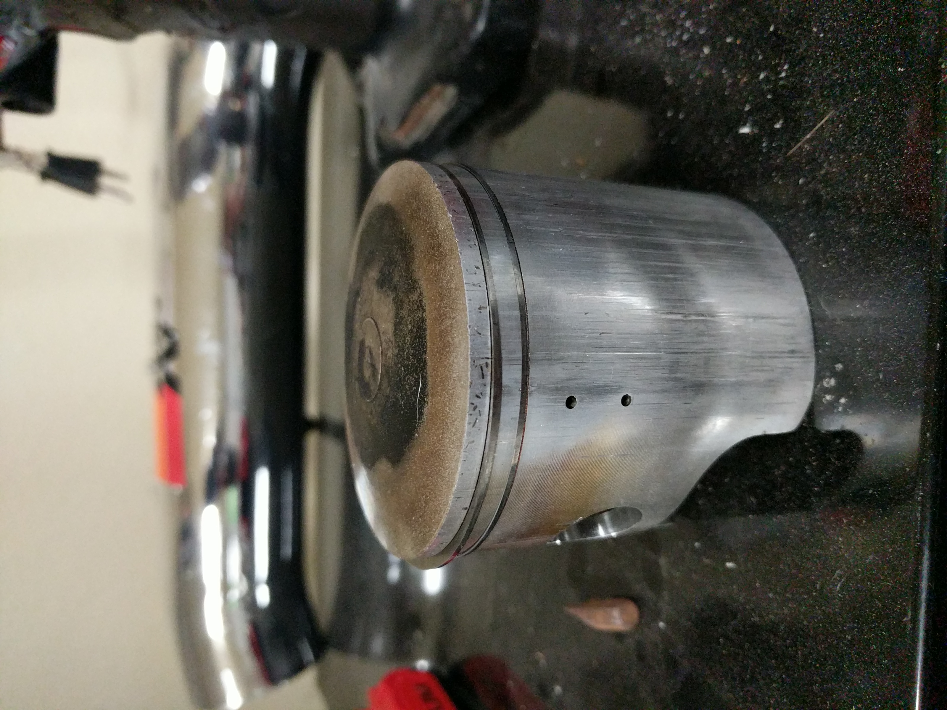

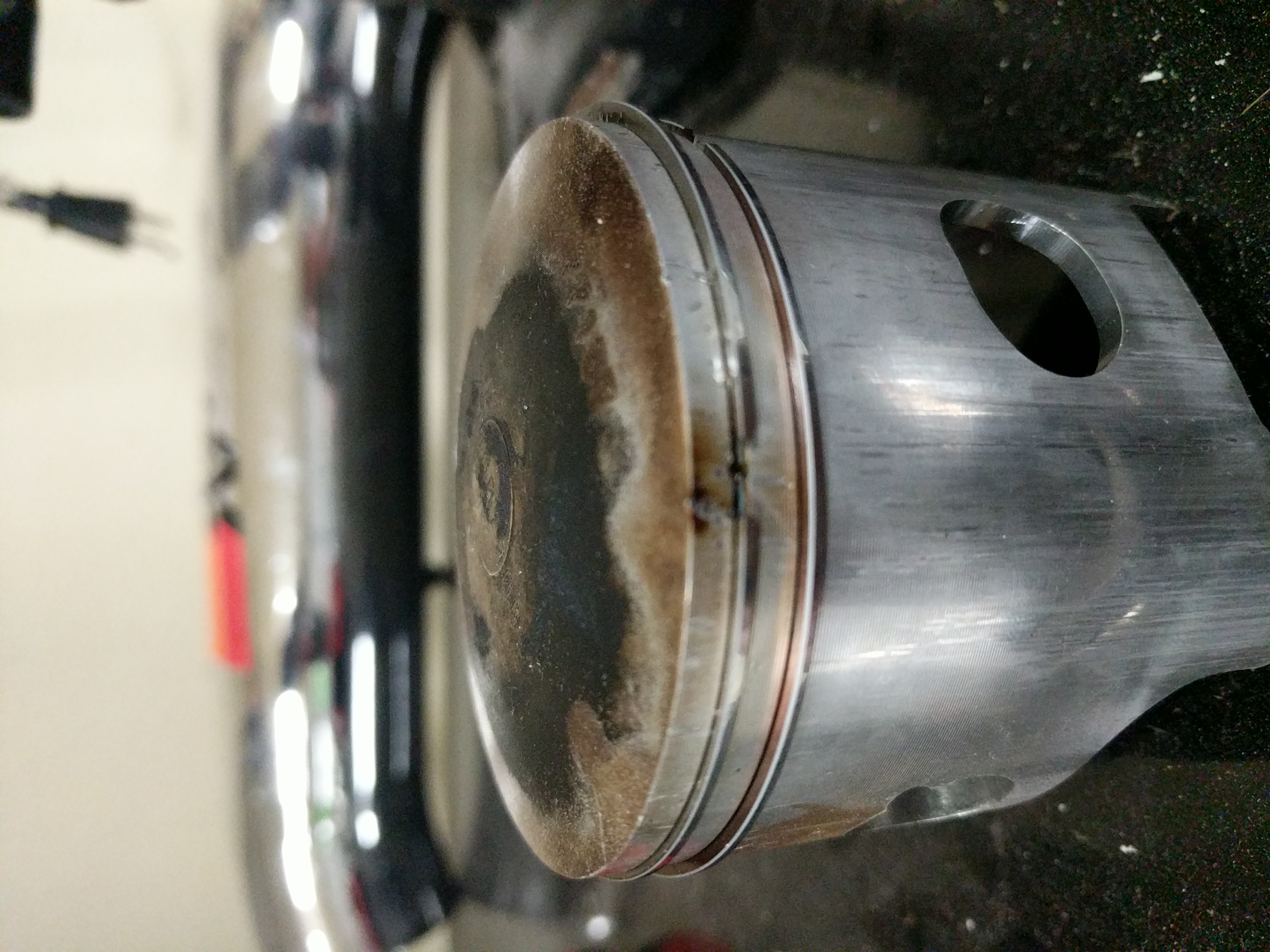

Maybe a little blow by where the upper ring comes together.

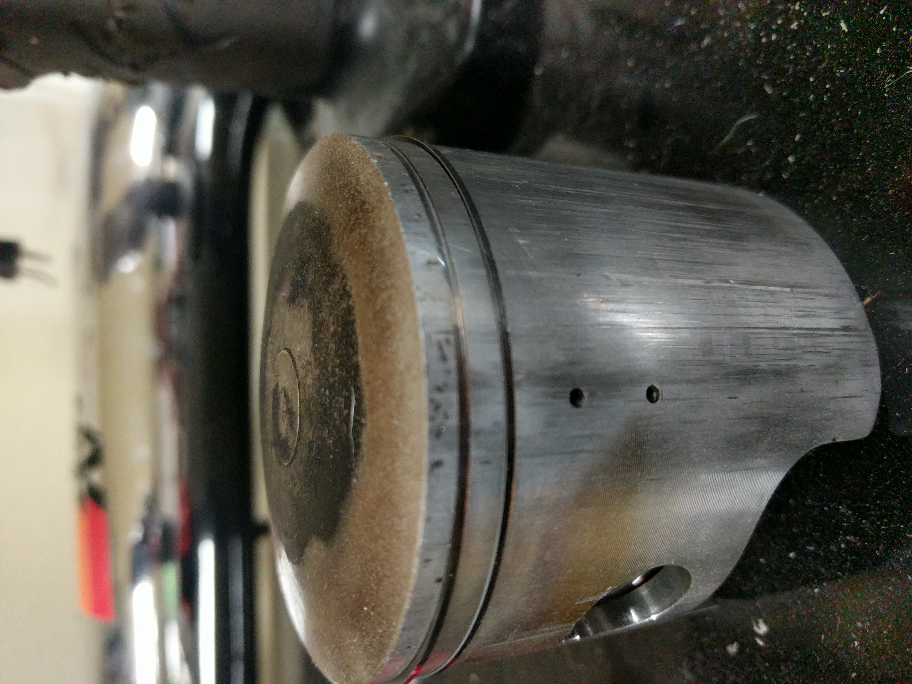

The little lines look like dirt scratches on the piston and cylinder.
If there is aluminum streaking on the cylinder walls, read up on muriatic acid.

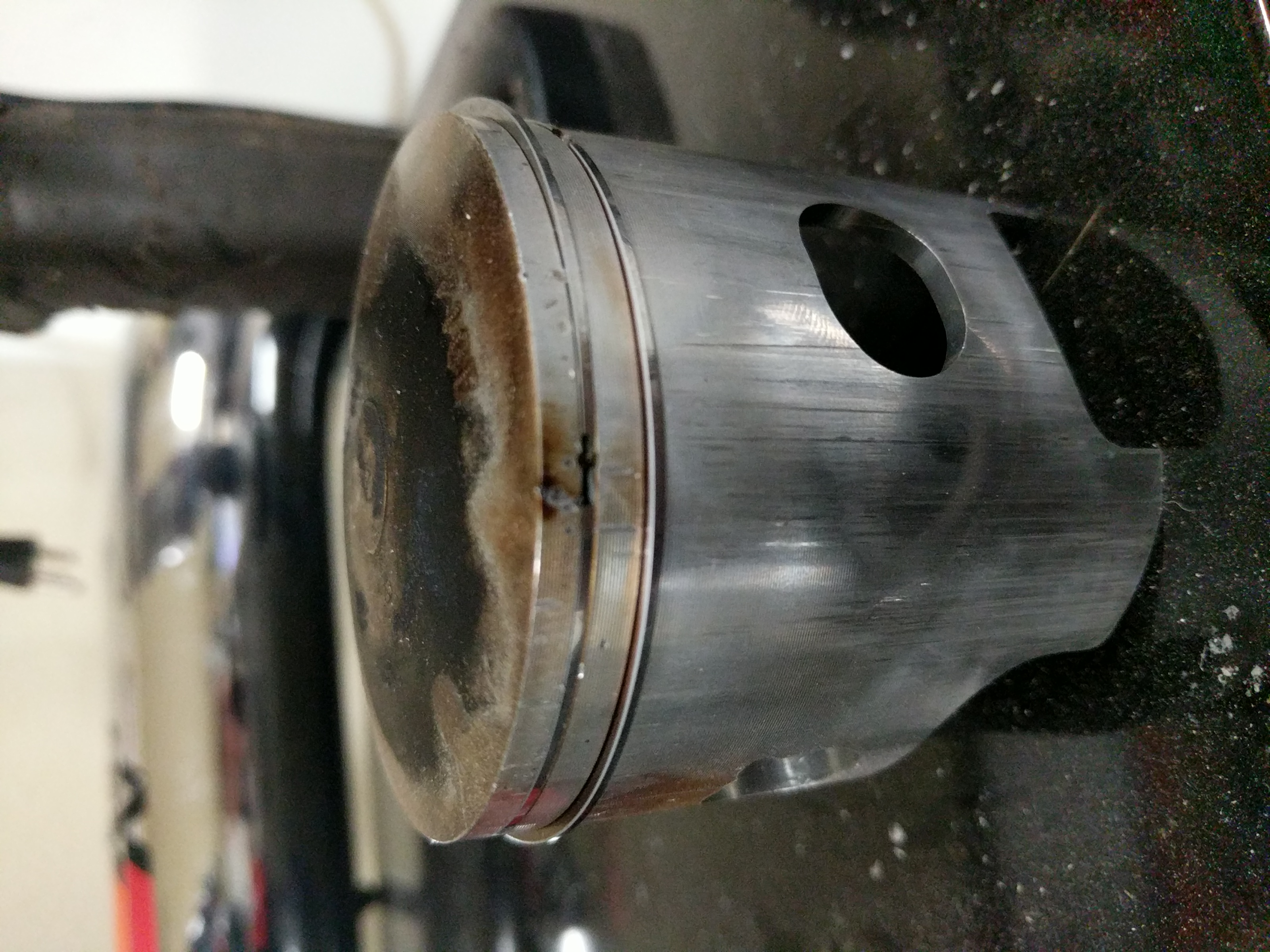

That's a siezed or nearly seized piston, autolube or premix? I put a 38carb on my 250 and got it wrong. Before mine locked up it was making a ticking sound.
The piston skirt is getting to hot and pinching. Is piston the correct size for barrel?

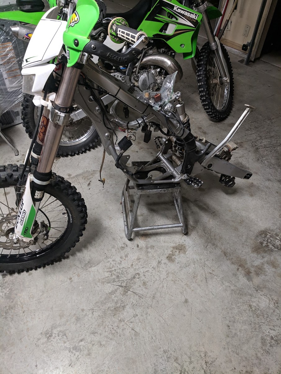

Kinda getting tired of this look...can't wait to ride it again,

I use motul 32.1 I'm not that brave... maybe main jet is restricted/ blocked that will make it run lean at top end. Worth checking before you start her up.
I got stitched up with a Chinese copy 38 keinlin, surpossed to be sudco tuned. It wrecked my original sr barrel and piston, and also started to siez kx barrel I put on , all my pistons looked just like yours. Also if crank seal is gone that will draw air in through seal instead of carb. Could possibly make it run lean. Still think it's nipping up... you would have marks on top of piston if anything was flying around in the cylinder.. just my opinion please correct me if I'm wrong

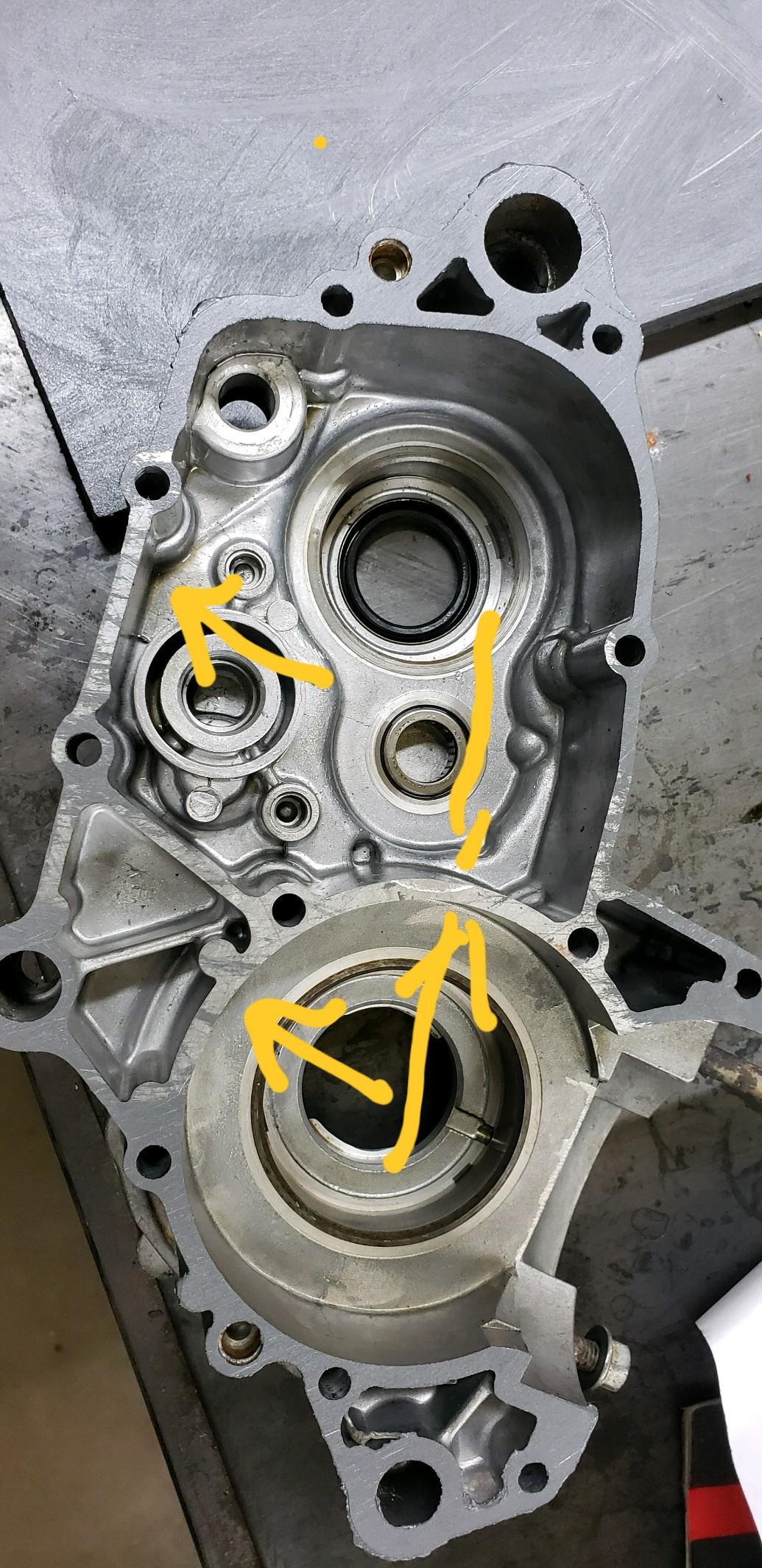

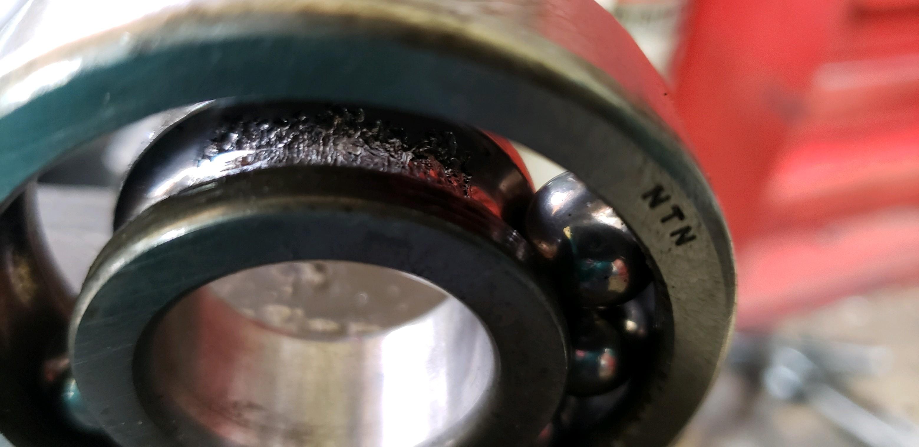

Well here is what I've got. The inner race on the main bearing (water pump side) was being chewed up. The metal that it was producing is what was getting into the combustion chamber. That metal is what you see on the piston. Fortunately, I caught it early enough to not mess up the cylinder or head. Lesson here is, if something doesn't sound right...shut it down before further damage occurs. Crazy thing is, the bike was still running normal.
It was also pointed out that the cases were not flush in some areas allowing pressure to move around in the bottom end where it shouldn't. Here is the image from the mechanic showing those areas. I guess it was a casting flaw from Kawi since this is the first time the cases have been split. He's going to clean that up and should have it back in a week or so. So... new top end, crank rebuilt, new rod, new bearings throughout...should be good to go for years.

...Thank you for the follow up. It is always good to get the autopsy report.
