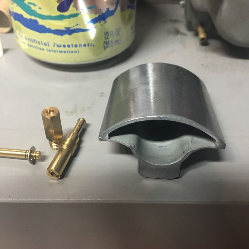

A quick update:
I found what I thought was a new "Keihin PWK 36" on ebay for $170:
No sizes engraved on the jets or slide, serial number number engraved in the side, no printing on the vent hoses, and no colored QC marks on the carb. It is amazing what detail the counterfeiters have included... what a shame.
When I cracked it open, i found that the jets were not labeled. Thinking that was strange, I called Sudco, the US importer, and found that this was counterfeit. I returned the carb after some minor hassle. I also found that the carb in the e-series is actually a PWK 35mm. It has a different size inlet and slide. I received it today and it runs great!
