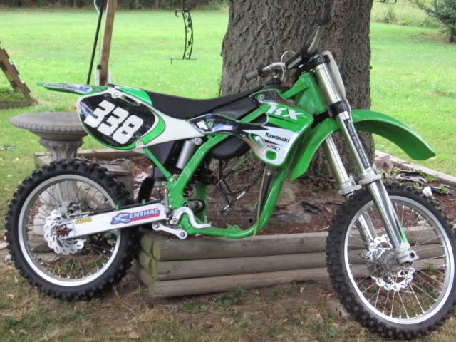

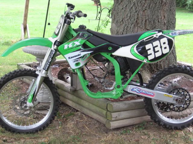

thanks rbates9 but im just not realy into the 250's right now.heres some pics of how the roller sitting right now.
[IMG::]http://i393.photobucket.com/albums/pp15 ... G_2417.jpg[/img]
[IMG::]http://i393.photobucket.com/albums/pp15 ... G_2416.jpg[/img]
its all in the thread that i posted of whats has been done to it.

what i was thinking was to swap out the 250 frame for a 125 an build a hybrid out of my 00/01 bike.im looking at 99-02 125 frames on ebay right now as this is the root i think i might take.the 04 frame an swing arm is all i have to start with an i would have to get plastics,gas tank,wheels,brakes ect... to finish so i think im going to just get 125 frame for the 99-02 bike an do a hybrid this way.my 00/01 roller i have about $1800 into now without even touching the motor an that needs a complete rebuild an plate job.this was going to be my nice bike but ive kind of lost interest in the 250 smokers.
