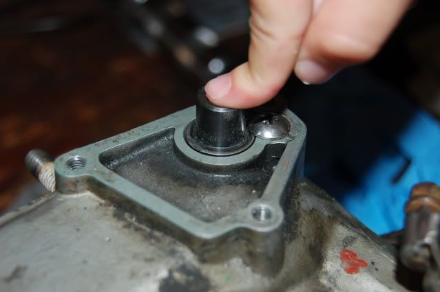

Here is how it's supposed to sit.

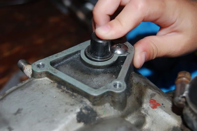

Here is how much it moves even with the seating screw fully tightened.

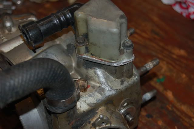

The solution--Bigfoot in the flesh!!!!
I made the plate out of some aluminum I had bought to make my hybrid headstays last year. I made a rubbing of the seating surface using paper and a crayon, and then I was able to transfer the hole centers onto the aluminum with a punch. A few holes drilled on the drill press, a little coping saw action, and a little dressing up with files and sandpaper, and Bob's yer uncle!
You have to remove the c-clips that hold the collar at the end of the shaft so that you can slip the plate on, and then reassemble the shaft. I used a little gasket maker between the plate and the cylinder, and I used the paper gasket between the cover and the plate.

Ya'll abovce might want to double check wether yours has play or not. 3 E series bikes i've checked all had the same play in that bushing/sleeve/collar whatever you wanna call it. One screw is just not enough to secure it.
